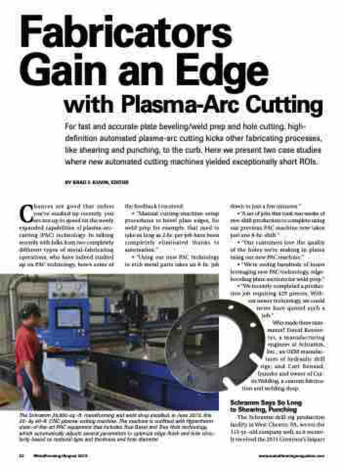

Gain an Edge with Plasma-Arc Cutting
For fast and accurate plate beveling/weld prep and hole cutting, high- definition automated plasma-arc cutting kicks other fabricating processes, like shearing and punching, to the curb. Here we present two case studies where new automated cutting machines yielded exceptionally short ROIs.

  The Schramm 30,000-sq.-ft. metalforming and weld shop installed, in June 2010, this 20- by 40-ft. CNC plasma-cutting machine. The machine is outfitted with Hypertherm state-of-the-art PAC equipment that includes True Bevel and True Hole technology, which automatically adjusts several parameters to optimize edge finish and hole circu- larity based on material type and thickness and hole diameter.
