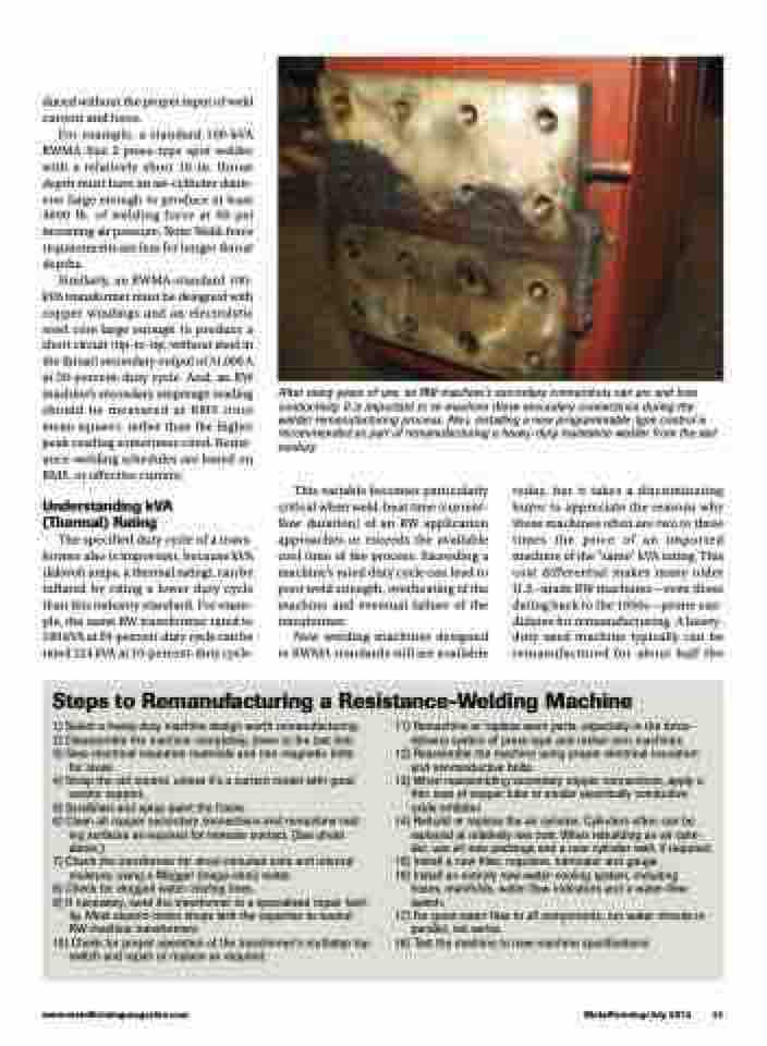

After many years of use, an RW machine’s secondary connections can arc and lose conductivity. It is important to re-machine these secondary connections during the welder remanufacturing process. Also, installing a new programmable-type control is recommended as part of remanufacturing a heavy-duty resistance welder from the last century.

6) Clean all copper secondary connections and remachine mat-
ing surfaces as required for intimate contact. (See photo
above.)
