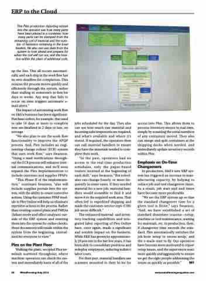

  This Plex production-reporting screen lets the operator see how many parts have been placed in a container, how many parts can be stamped from the
remaining coil of material and the num- ber of fasteners remaining in the bowl feeders. He also can use data from the system to look ahead and prepare for when the coil will run out, and the loca- tion within the plant of additional coils.
