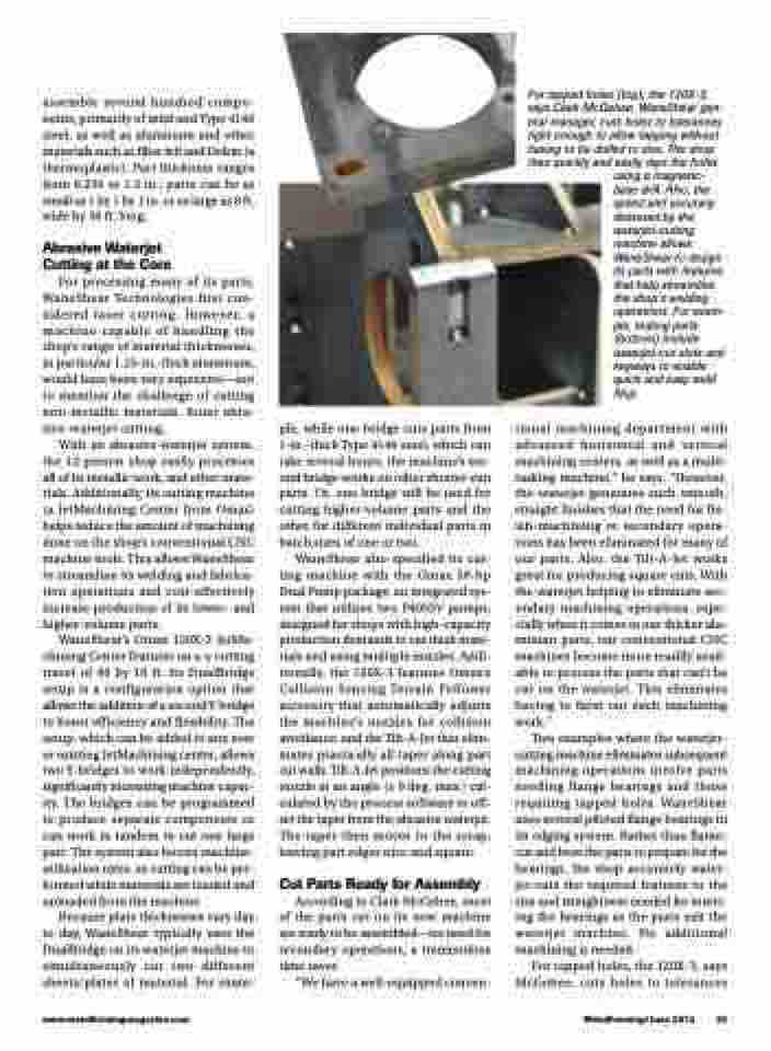

For tapped holes (top), the 120X-3, says Clark McGehee, WaneShear gen- eral manager, cuts holes to tolerances tight enough to allow tapping without having to be drilled to size. The shop then quickly and easily taps the holes
using a magnetic- base drill. Also, the speed and accuracy delivered by the waterjet-cutting machine allows WaneShear to design its parts with features that help streamline the shop’s welding operations. For exam- ple, mating parts (bottom) include waterjet-cut slots and keyways to enable quick and easy weld fitup.

Two examples where the waterjet- cutting machine eliminates subsequent machining operations involve parts needing flange bearings and those requiring tapped holes. WaneShear uses several piloted flange bearings in its edging system. Rather than flame- cut and bore the parts to prepare for the bearings, the shop accurately water- jet-cuts the required features to the size and straightness needed for insert- ing the bearings as the parts exit the waterjet machine. No additional machining is needed.
For tapped holes, the 120X-3, says McGehee, cuts holes to tolerances
