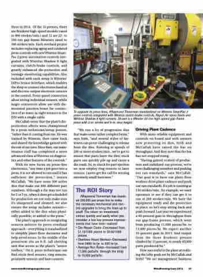

To upgrade its press lines, ARaymond Tinnerman standardized on Wintriss SmartPac 2 press controls integrated with Wintriss clutch-brake controls, Rapid-Air servo feeds and Wintriss Shadow 8 light curtains. Shown is a Minster 22-ton high-speed gap-frame press with 2-in. stroke and 9-in. shut height.
