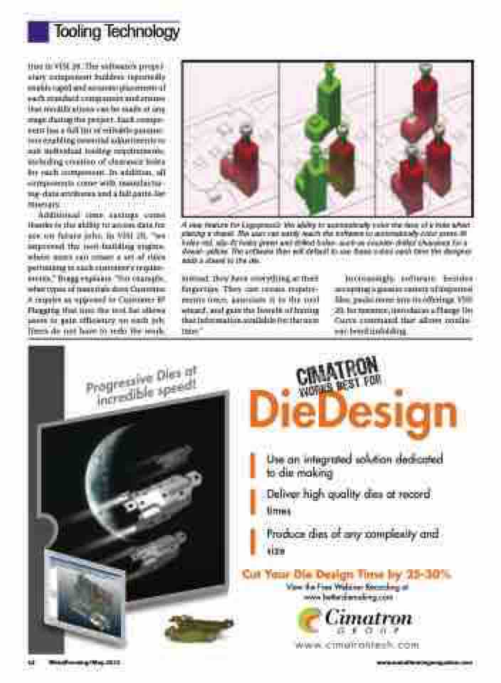

A new feature for Logopress3: the ability to automatically color the face of a hole when placing a dowel. The user can easily teach the software to automatically color press-fit holes red, slip-fit holes green and drilled holes—such as counter-drilled clearance for a dowel—yellow. The software then will default to use these colors each time the designer adds a dowel to the die.
