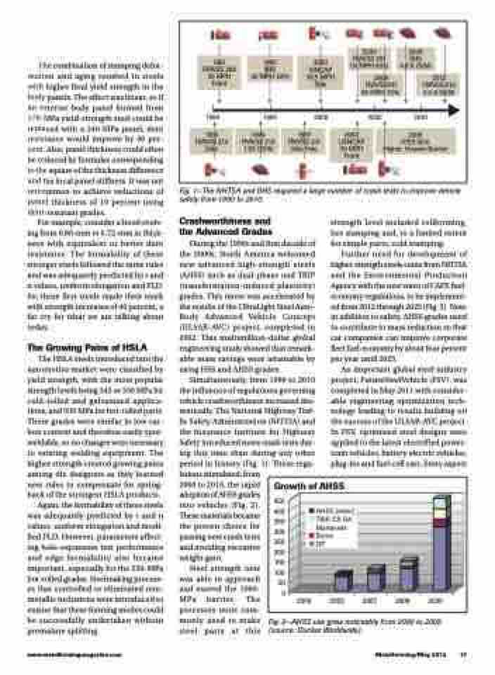

             2003 FMVSS 301 50 MPH 50%
   1991 FMVSS 208 30 MPH Front
1995 IIHS
40 MPH 40%
2000 SINCAP 38.5 MPH Side
4.
2009 IIHS
0XGVW
  2006 FMVSS301 55 MPH 70%
2012 FMVSS 216 3.0 X GVW
 1990 1995 2000 2005 2010
      1990 FMVSS 214 Side
 1994 FMVSS 216 1.5X GVW
 1997 FMVSS 201 Side Pole
   2003 USNCAP 35 MPH Front
2006
IHSS Side Higher, Heavier Barrier

Fig. 1—The NHTSA and IIHS required a large number of crash tests to improve vehicle safety from 1990 to 2010.

Simultaneously, from 1990 to 2010 the influence of regulations governing vehicle crashworthiness increased dra- matically. The National Highway Traf- fic Safety Administration (NHTSA) and the Insurance Institute for Highway Safety introduced more crash tests dur- ing this time than during any other period in history (Fig. 1). These regu- lations stimulated, from
2000 to 2010, the rapid
adoption of AHSS grades
into vehicles (Fig. 2).
These materials became
the proven choice for
passing new crash tests
and avoiding excessive
weight gain.

  Growth of AHSS
450
400
350
300
250
200
150
100
50 0
       2000 2005 2007
2009 2020
   AHSS (other) TRIP, CP, RA Martensite Boron
DP
                     Steel strength now was able to approach and exceed the 1000- MPa barrier. The processes most com- monly used to make steel parts at this
Fig. 2—AHSS use grew noticeably from 2000 to 2009 (source: Ducker Worldwide).
