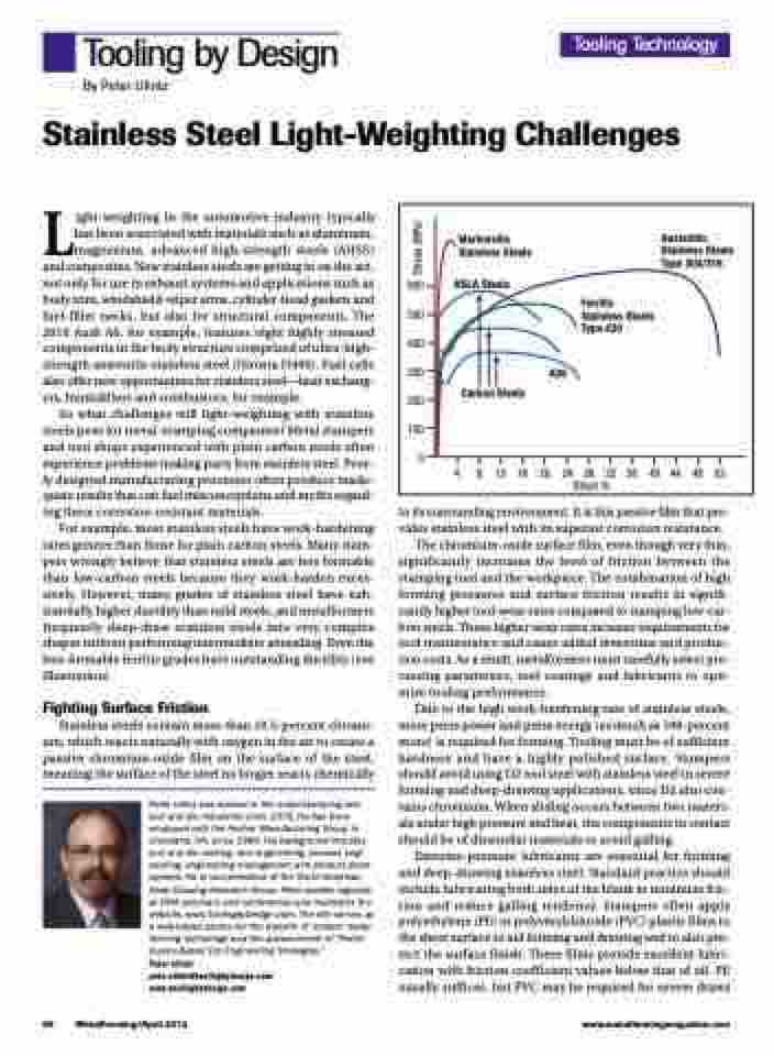

For example, most stainless steels have work-hardening rates greater than those for plain carbon steels. Many stam- pers wrongly believe that stainless steels are less formable than low-carbon steels because they work-harden exces- sively. However, many grades of stainless steel have sub- stantially higher ductility than mild steels, and metalformers frequently deep-draw stainless steels into very complex shapes without performing intermediate annealing. Even the less-formable ferritic grades have outstanding ductility (see illustration).

8 12 16 20 24 28 32 36 40 44 48 52 Strain %
Carbon Steels
A36
