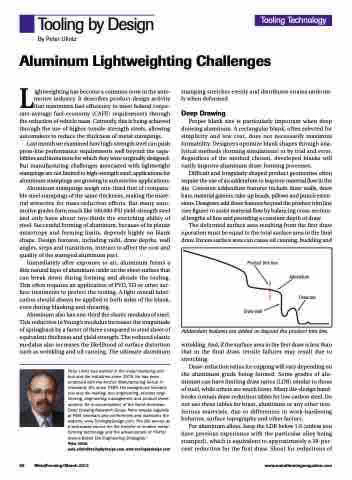

Difficult and irregularly shaped product geometries often require the use of an addendum to improve material flow in the die. Common addendum features include draw walls, draw bars, material gainers, take-up beads, pillows and punch exten- sions. Designers add these features beyond the product trim line (see figure) to assist material flow by balancing cross-section- al lengths of line and providing a constant depth of draw.
The deformed surface area resulting from the first draw operation must be equal to the total surface area in the final draw. Excess surface area can cause oil canning, buckling and

  Product trim line
Draw wall
Addendum
Draw bar
     Addendum features are added on beyond the product trim line.
wrinkling. And, if the surface area in the first draw is less than that in the final draw, tensile failures may result due to stretching.
