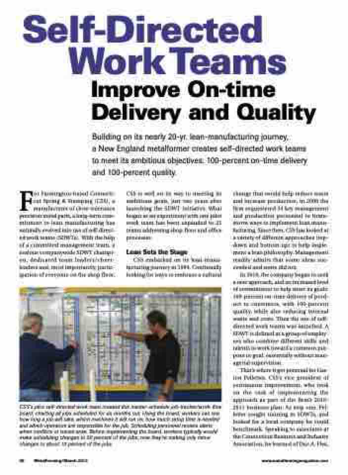

 CSS’s pilot self-directed work team created this master-schedule job-tracker/work-flow board, charting all jobs scheduled for six months out. Using the board, workers can see how long a job will take, which machines it will run on, how much setup time is needed and which operators are responsible for the job. Scheduling personnel receive alerts when conflicts or issues arise. Before implementing the board, workers typically would make scheduling changes to 50 percent of the jobs; now they’re making only minor changes to about 10 percent of the jobs.
