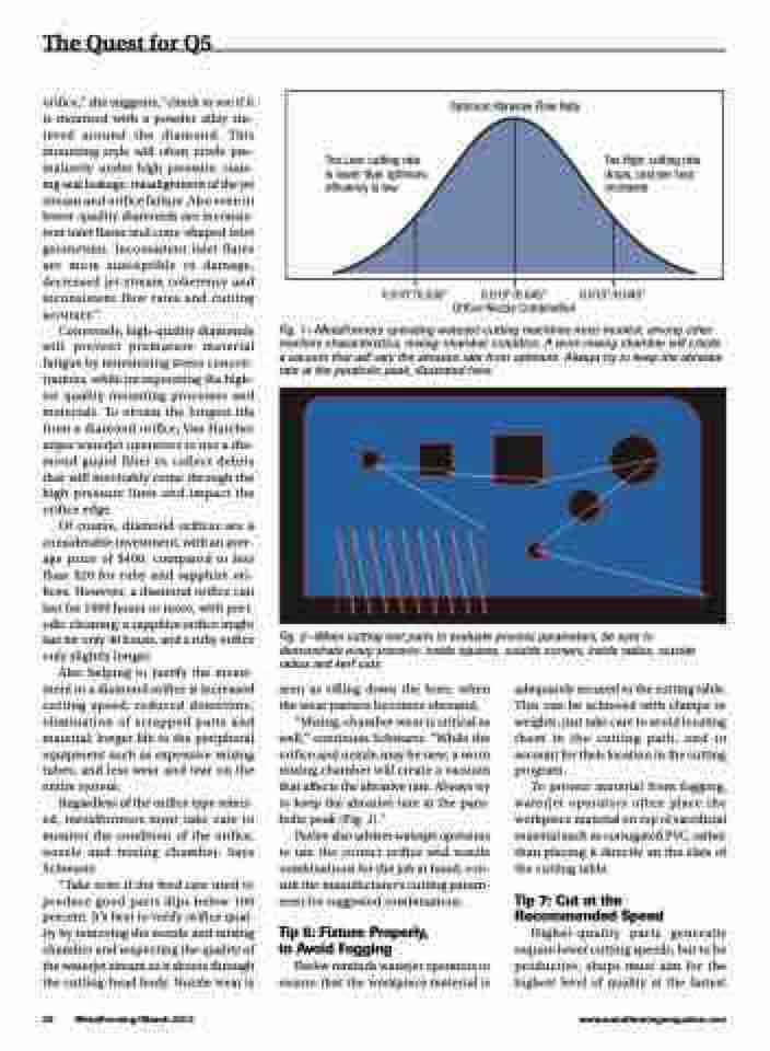

     0.010"/0.030" 0.013"/0.045" 0.015"/0.045" Orifice-Nozzle Combination
 Optimum Abrasive Flow Rate
  Too Low: cutting rate is lower than optimum, efficiency is low
Too High: cutting rate drops, cost per hour increases

Regardless of the orifice type select- ed, metalformers must take care to monitor the condition of the orifice, nozzle and mixing chamber. Says Schwartz:
“Take note if the feed rate used to produce good parts dips below 100 percent. It’s best to verify orifice qual- ity by removing the nozzle and mixing chamber and inspecting the quality of the waterjet stream as it shoots through the cutting-head body. Nozzle wear is
Fig. 1—Metalformers operating waterjet-cutting machines must monitor, among other machine characteristics, mixing-chamber condition. A worn mixing chamber will create a vacuum that will vary the abrasive rate from optimum. Always try to keep the abrasive rate at the parabolic peak, illustrated here.
                               28 MetalForming/March 2013
Fig. 2—When cutting test parts to evaluate process parameters, be sure to demonstrate every scenario: inside squares, outside corners, inside radius, outside radius and kerf cuts.
seen as rifling down the bore, when the wear pattern becomes obround.
“Mixing-chamber wear is critical as well,” continues Schwartz. “While the orifice and nozzle may be new, a worn mixing chamber will create a vacuum that affects the abrasive rate. Always try to keep the abrasive rate at the para- bolic peak (Fig. 1).”
