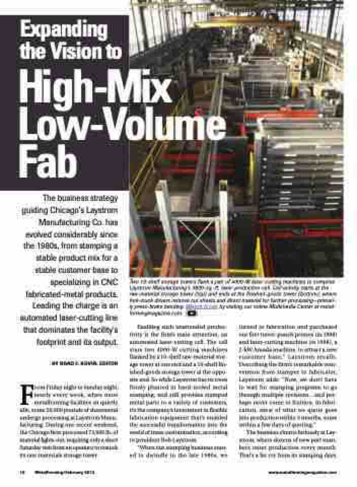

Two 10-shelf storage towers flank a pair of 4000-W laser-cutting machines to comprise Laystrom Manufacturing’s 3800-sq.-ft. laser-production cell. Cell activity starts at the raw-material storage tower (top) and ends at the finished-goods tower (bottom), where fork-truck drivers remove cut sheets and direct material for further processing—primari- ly press-brake bending. Watch it run by visiting our online Multimedia Center at metal- formingmagazine.com.
