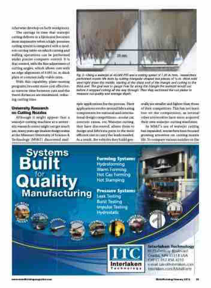

Fig. 2—Using a waterjet at 40,000 PSI and a cutting speed of 1.25 in./min., researchers performed nozzle-life tests by cutting triangular-shaped test pieces of 1⁄4-in.-thick mild steel right down the middle, starting at the sharp end of the triangle and cutting to the thick end. The goal was to gauge how far along the triangle the waterjet would cut before it stopped cutting all the way through. Then they sectioned the cut plates to measure cut quality and average depth.
