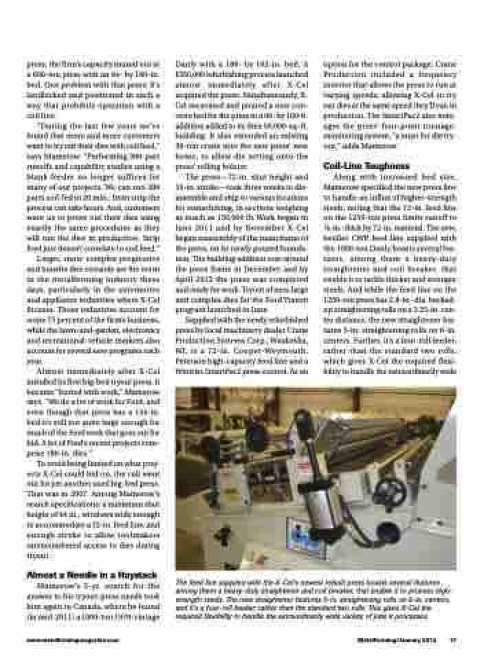

Along with increased bed size, Mamerow specified the new press line to handle an influx of higher-strength steels, noting that the 72-in. feed line on the 1250-ton press limits runoff to 1⁄8-in.-thick by 72-in. material. The new, beefier CWP feed line supplied with the 1000-ton Danly boasts several fea- tures, among them a heavy-duty straightener and coil breaker, that enable it to tackle thicker and stronger steels. And while the feed line on the 1250-ton press has 2.8-in.-dia. backed- up straightening rolls on a 3.25-in. cen- ter distance, the new straightener fea- tures 5-in. straightening rolls on 6-in. centers. Further, it’s a four-roll feeder, rather than the standard two rolls, which gives X-Cel the required flexi- bility to handle the extraordinarily wide

The feed line supplied with the X-Cel’s newest rebuilt press boasts several features , among them a heavy-duty straightener and coil breaker, that enable it to process high- strength steels. The new straightener features 5-in. straightening rolls on 6-in. centers, and it’s a four-roll feeder, rather than the standard two rolls. This gives X-Cel the required flexibility to handle the extraordinarily wide variety of jobs it processes.
