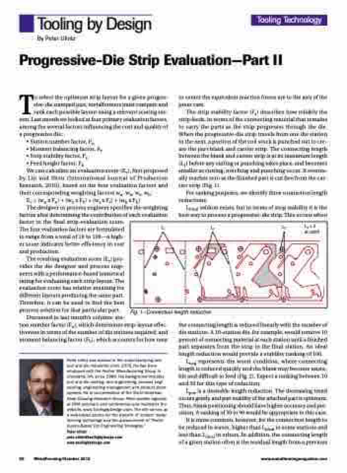

The strip stability factor (F ) describes how reliably the s
strip feeds, in terms of the connecting material that remains to carry the parts as the strip progresses through the die. When the progressive-die strip travels from one die station to the next, a portion of the coil stock is punched out to cre- ate the part blank and carrier strip. The connecting length between the blank and carrier strip is at its maximum length (L1) before any cutting or punching takes place, and becomes smaller as cutting, notching and punching occur. It eventu- ally reaches zero as the finished part is cut free from the car- rier strip (Fig. 1).
For ranking purposes, we identify three connection length reductions:
Lideal seldom exists, but in terms of strip stability it is the best way to process a progressive-die strip. This occurs when

Fig. 1—Connection length reduction

the connecting length is reduced linearly with the number of die stations. A 10-station die, for example, would remove 10 percent of connecting material at each station until a finished part separates from the strip in the final station. An ideal length reduction would provide a stability ranking of 100.
Lneg represents the worst condition, where connecting length is reduced quickly and the blank may become unsta- ble and difficult to feed (Fig. 2). Expect a ranking between 10 and 50 for this type of reduction.
Lpos is a desirable length reduction. The decreasing trend occurs gently, and part stability of the attached part is optimum. Thus, blank positioning should have higher accuracy and pre- cision. A ranking of 50 to 90 would be appropriate in this case.
It is more common, however, for the connection length to be reduced in waves, higher than Lideal in some stations and less than Lideal in others. In addition, the connecting length of a given station often is the residual length from a previous
