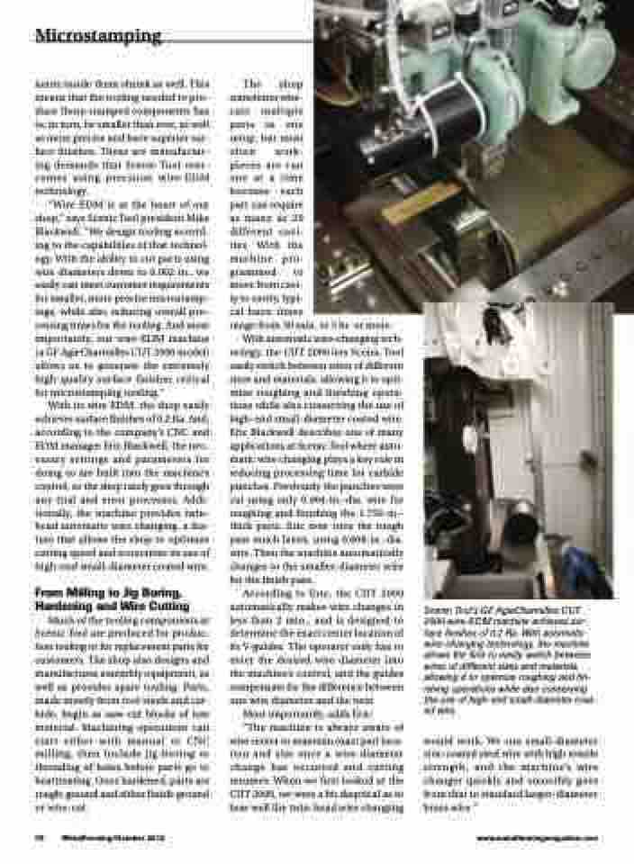

Scenic Tool’s GF AgieCharmilles CUT 2000 wire-EDM machine achieves sur- face finishes of 0.2 Ra. With automatic wire-changing technology, the machine allows the firm to easily switch between wires of different sizes and materials, allowing it to optimize roughing and fin- ishing operations while also conserving the use of high-end small-diameter coat- ed wire.
