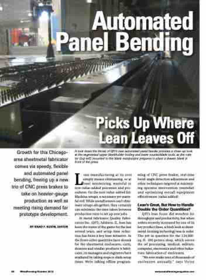

A look down the throat of QFI’s new automated panel bender provides a close-up look at the segmented upper blankholder tooling and lower counterblade tools, as the rota- tor (top left) mounted to the blank manipulator prepares to place a drawer blank in front of the press.
