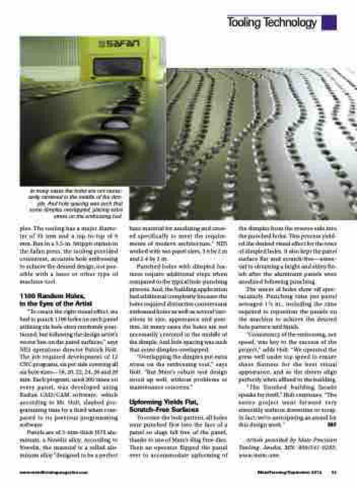

  In many cases the holes are not neces- sarily centered in the middle of the dim- ple. And hole spacing was such that some dimples overlapped, placing extra stress on the embossing tool.

Punched holes with dimpled fea- tures require additional steps when compared to the typical hole-punching process. And, the building application had additional complexity because the holes required distinctive countersunk embossed holes as well as several vari- ations in size, appearance and posi- tion. In many cases the holes are not necessarily centered in the middle of the dimple. And hole spacing was such that some dimples overlapped.
“Overlapping the dimples put extra stress on the embossing tool,” says Holt. “But Mate’s robust tool design stood up well, without problems or maintenance concerns.”

To create the hole pattern, all holes were punched first into the face of a panel so slugs fell free of the panel, thanks to use of Mate’s Slug Free dies. Then an operator flipped the panel over to accommodate upforming of
the dimples from the reverse side into the punched holes. This process yield- ed the desired visual effect for the rows of dimpled holes. It also kept the panel surface flat and scratch-free—essen- tial to obtaining a bright and shiny fin- ish after the aluminum panels were anodized following punching.
