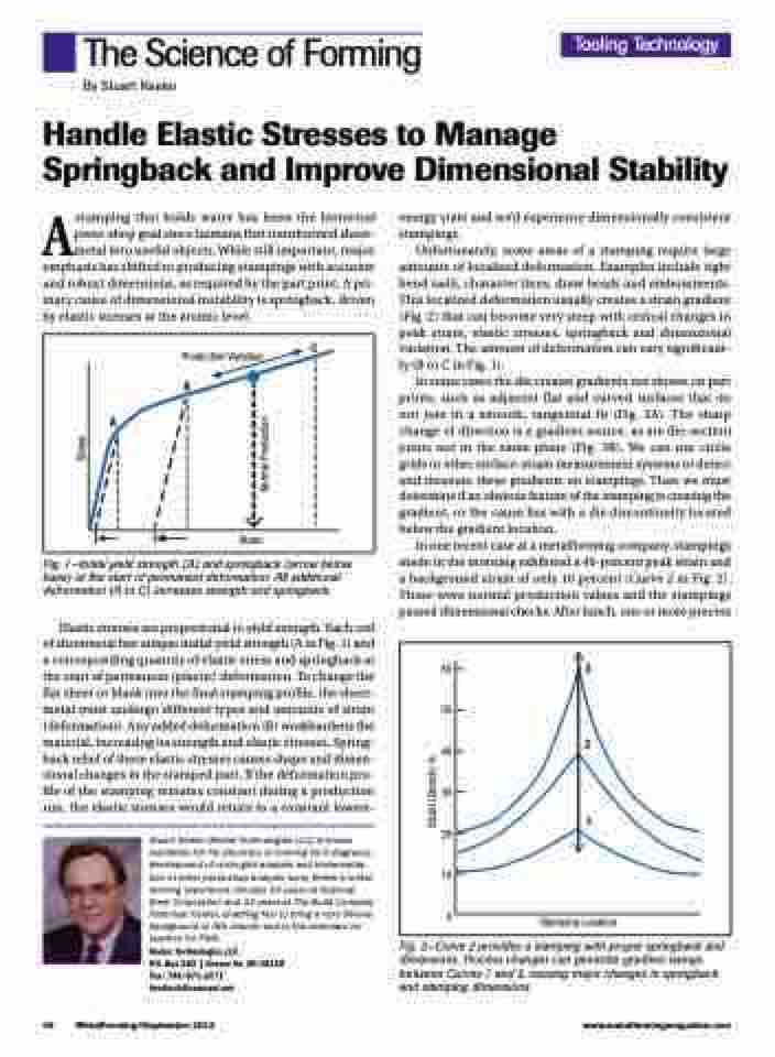

Astamping that holds water has been the historical press-shop goal since humans first transformed sheet- metal into useful objects. While still important, major emphasis has shifted to producing stampings with accurate and robust dimensions, as required by the part print. A pri- mary cause of dimensional instability is springback, driven by elastic stresses at the atomic level.
energy state and we’d experience dimensionally consistent stampings.
Unfortunately, some areas of a stamping require large amounts of localized deformation. Examples include tight bend radii, character lines, draw beads and embossments. This localized deformation usually creates a strain gradient (Fig. 2) that can become very steep with critical changes in peak strain, elastic stresses, springback and dimensional variation. The amount of deformation can vary significant- ly (B to C in Fig. 1).
In some cases the die creates gradients not shown on part prints, such as adjacent flat and curved surfaces that do not join in a smooth, tangential fit (Fig. 3A). The sharp change of direction is a gradient source, as are die-section joints not in the same plane (Fig. 3B). We can use circle grids or other surface-strain measurement systems to detect and measure these gradients on stampings. Then we must determine if an obvious feature of the stamping is creating the gradient, or the cause lies with a die discontinuity located below the gradient location.
In one recent case at a metalforming company, stampings made in the morning exhibited a 40-percent peak strain and a background strain of only 10 percent (Curve 2 in Fig. 2). These were normal production values and the stampings passed dimensional checks. After lunch, one or more process
Fig. 1—Initial yield strength (A) and springback (arrow below base) at the start of permanent deformation. All additional deformation (A to C) increases strength and springback.
Elastic stresses are proportional to yield strength. Each coil of sheetmetal has unique initial yield strength (A in Fig. 1) and a corresponding quantity of elastic stress and springback at the start of permanent (plastic) deformation. To change the flat sheet or blank into the final stamping profile, the sheet- metal must undergo different types and amounts of strain (deformation). Any added deformation (B) workhardens the material, increasing its strength and elastic stresses. Spring- back relief of these elastic stresses causes shape and dimen- sional changes in the stamped part. If the deformation pro- file of the stamping remains constant during a production run, the elastic stresses would return to a constant lowest-

Fig. 2—Curve 2 provides a stamping with proper springback and dimensions. Process changes can generate gradient swings between Curves 1 and 3, causing major changes in springback and stamping dimensions.
