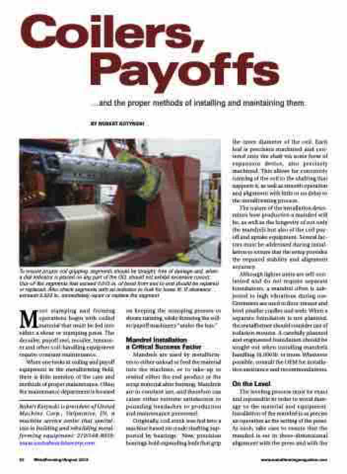

 To ensure proper coil gripping, segments should be straight, free of damage and, when a dial indicator is placed on any part of the OD, should not exhibit excessive runout. Out-of-flat segments that exceed 0.015 in. of bend from end to end should be repaired or replaced. Also check segments with an indicator to look for loose fit. If clearance exceeds 0.020 in., immediately repair or replace the segment.
