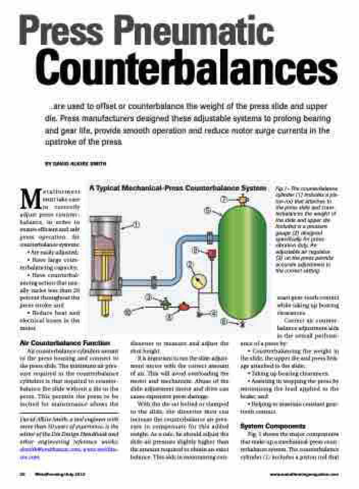

Air counterbalance cylinders mount to the press housing and connect to the press slide. The minimum air pres- sure required in the counterbalance cylinders is that required to counter- balance the slide without a die in the press. This permits the press to be inched for maintenance allows the

Fig.1—The counterbalance cylinder (1) includes a pis- ton rod that attaches to the press slide and coun- terbalances the weight of the slide and upper die. Included is a pressure gauge (2) designed specifically for press- vibration duty. An adjustable air regulator (3) on the press permits accurate adjustment to the correct setting.

Fig. 1 shows the major components that make up a mechanical-press coun- terbalance system. The counterbalance cylinder (1) includes a piston rod that
A Typical Mechanical-Press Counterbalance System
diesetter to measure and adjust the shut height.
It is important to run the slide-adjust- ment motor with the correct amount of air. This will avoid overloading the motor and mechanism. Abuse of the slide-adjustment motor and drive can cause expensive press damage.
With the die set bolted or clamped to the slide, the diesetter then can increase the counterbalance air pres- sure to compensate for this added weight. As a rule, he should adjust the slide air pressure slightly higher than the amount required to obtain an exact balance. This aids in maintaining con-
