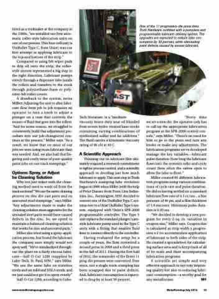

One of the 11 progressive-die press lines Truth Hardware outfitted with a pumpless and programmable lubricant-delivery system. The upgrades are expected to reduce lube con- sumption by 30 percent, while eliminating paint defects caused by excess lubricant.

Thinning out its lubricant film ulti- mately required a renewed commitment to tighter process control, and a scientific approach to deciding just how much lubricant to apply. This next step in Truth Hardware’s stamping-lube evolution began in 2006 when Miller (with the help of Peter Danzer from Press Line Indus- tries, Inc., Farmington, MN) decided to convert one of the UniRoller Type C sys- tems over to a Unist UniRoller Type S sys- tem, equipped with Unist’s SPR-2000 programmable controller. The Type S unit replaces the standard plunger/cam- style lubricant pump used in the Type C units with a fitting that enables fluid lines to connect directly to the controller.
Having evaluated the setup for a couple of years, the firm converted a second press in 2008 and a third press in the fall of 2011. During the first half of 2012, the remainder of the firm’s 11 prog-die presses were converted. Ever since, not a single track stamping has been scrapped due to paint defects. And, lubricant consumption is expect- ed to drop by at least 30 percent.
“Every time we set a new die, the operator only has to call up the appropriate lubrication program at the SPR-2000 control con- sole,” says Miller. “There’s no need for him to go to the press and turn any knobs or make any adjustments. The lubrication programs we’ve developed manage the key variables—lubricant pulse duration (how long the lubricant flows into the system’s rolls) and cycle count (how often the valves open to
allow the lube to flow).”
Miller created 60 different lubrica-
tion programs using various combina- tions of cycle rate and pulse duration. He did so having settled on a standard lubricant flow rate of 4.3 cc/sec., a line pressure of 40 psi, and a film thickness of 3.6 microns. Minimum pulse dura- tion is 0.05 sec.
“We decided to develop a new pro- gram for every 2-sq.-in. variation in coupon size,” Miller says. Coupon size is calculated as strip width x progres- sion x 2 (to accommodate application of lubricant to both sides of the strip. He created a spreadsheet for calculat- ing surface area and to keep track of all of its tools and their accompanying lubrication programs.
