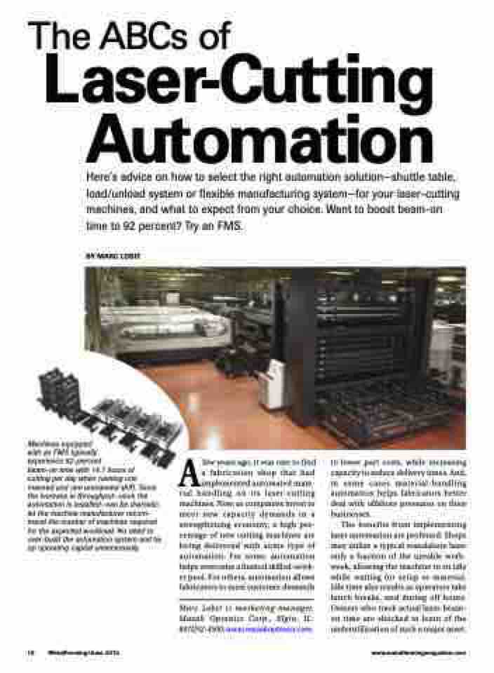

Here’s advice on how to select the right automation solution—shuttle table, load/unload system or flexible manufacturing system—for your laser-cutting machines, and what to expect from your choice. Want to boost beam-on time to 92 percent? Try an FMS.
BY MARC LOBIT
  Machines equipped
with an FMS typically
experience 92-percent
beam-on time with 14.7 hours of
cutting per day when running one manned and one unmanned shift. Since the increase in throughput—once the automation is installed—can be dramatic, let the machine manufacturer recom- mend the number of machines required for the expected workload. No need to over-build the automation system and tie up operating capital unnecessarily.
