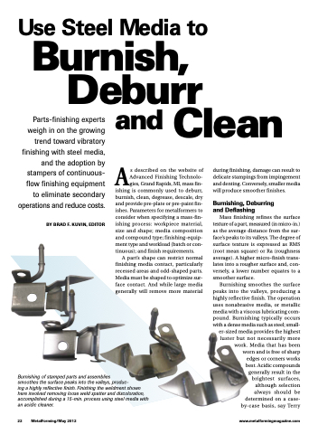

Burnishing of stamped parts and assemblies
smoothes the surface peaks into the valleys, produc-
ing a highly reflective finish. Finishing the weldment shown here involved removing loose weld spatter and discoloration, accomplished during a 15-min. process using steel media with an acidic cleaner.
