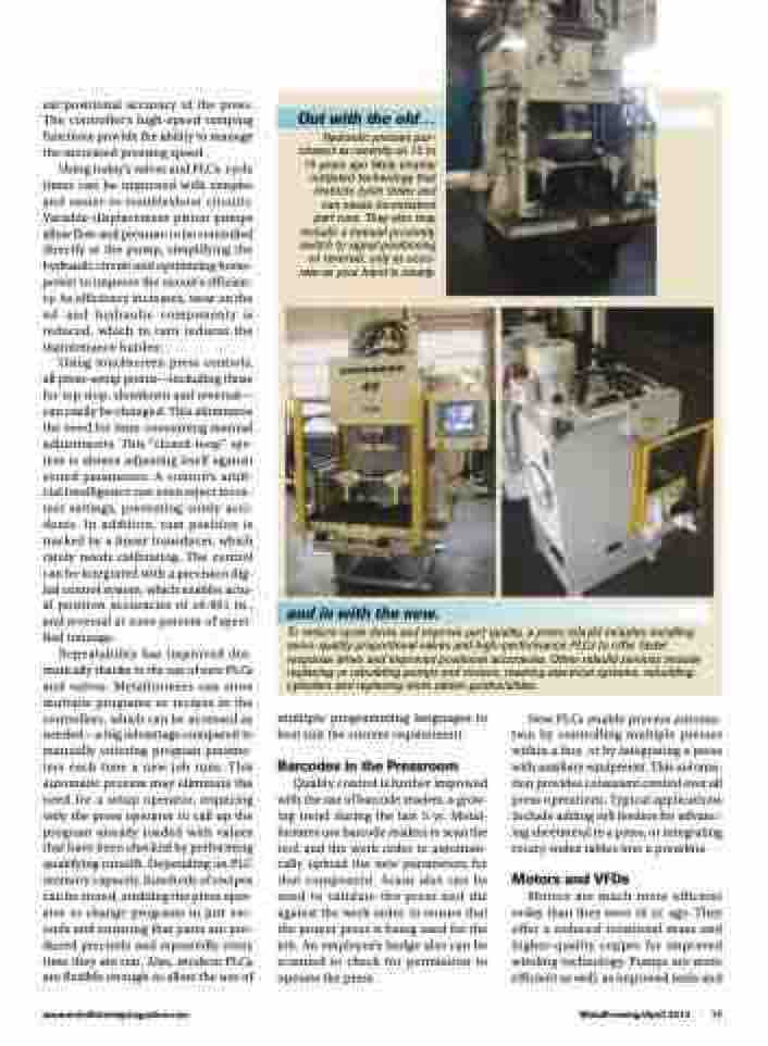

 Out with the old...
Hydraulic presses pur- chased as recently as 10 to 15 years ago likely employ outdated technology that restricts cycle times and can cause inconsistent part runs. They also may include a manual proximity switch to signal positioning on reversal, only as accu- rate as your hand is steady.
  and in with the new.
To reduce cycle times and improve part quality, a press rebuild includes installing servo-quality proportional valves and high-performance PLCs to offer faster response times and improved positional accuracies. Other rebuild services include replacing or rebuilding pumps and motors, rewiring electrical systems, rebuilding cylinders and replacing worn platen guides/slides.
