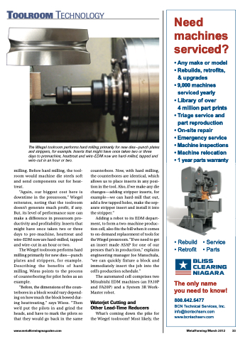

   The Wiegel toolroom performs hard milling primarily for new dies—punch plates and strippers, for example. Inserts that might have once taken two or three days to premachine, heattreat and wire-EDM now are hard-milled, tapped and wire-cut in an hour or two.

The Wiegel toolroom performs hard milling primarily for new dies—punch plates and strippers, for example. Describing the benefits of hard milling, Wiess points to the process of counterboring for pilot holes as an example.
“Before, the dimensions of the coun- terbores in a block would vary depend- ing on how much the block bowed dur- ing heattreating,” says Wiess. “Then we’d put the pilots in and grind the heads, and have to mark the pilots so that they would go back in the same
counterbore. Now, with hard milling, the counterbores are identical, which allows us to place inserts in any posi- tion in the tool. Also, if we make any die changes—adding stripper inserts, for example—we can hard-mill that out, add a few tapped holes, make the sep- arate stripper insert and install it into the stripper.”
