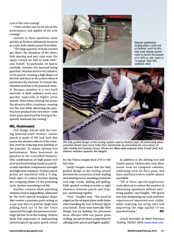

“The large quantity of holes needed per sheet, the thickness of the sheet, hole spacing and part runs were the major criteria we had to work with,” says Troxell. “In particular, we had to carefully consider the material being punched. Stainless steel is very abrasive to the punch, creating a high degree of friction and heat in the punch when it penetrates the material. To remain flat, stainless steel has to be punched clean- ly. Because stainless is a very hard material, it dulls ordinary tools very quickly, especially at higher press speeds. Even when slowing the press, the abrasive effect continues, wearing out the tool while distorting the part. You lose productivity two ways—with lower press speed and by having to fre- quently maintain the tooling.”

The fully guided design of the tooling system used at Dedoes pays off particularly when punched sheets have more holes than sheetmetal, by preventing the occurrence of side-loading and twisting forces. Shown are Mate sales engineer Gary Troxell (left) and Dedoes machine operator Pat Vaughn.

 Special-application tooling plays a vital role at Dedoes, such as this nine-hole cluster punch used to punch thousands of 0.1875-in.-dia. holes in 14-gauge Type 304 stainless steel.
