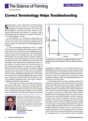

A critical amount of cold work can trigger formation of a few extremely large sheetmetal grains that cause early failure during forming.

0 Critical Desired Cold Work
    34 MetalForming/November 2011
Grain Size
Small Large Dangerous
