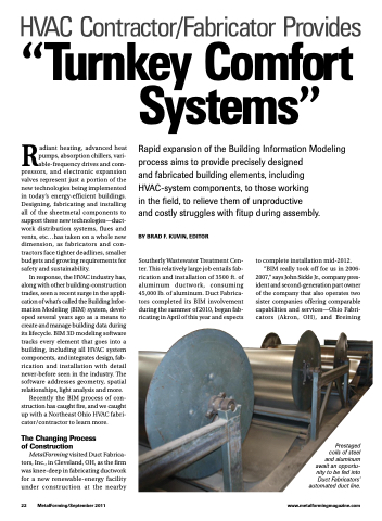

Southerly Wastewater Treatment Cen- ter. This relatively large job entails fab- rication and installation of 3500 ft. of aluminum ductwork, consuming 45,000 lb. of aluminum. Duct Fabrica- tors completed its BIM involvement during the summer of 2010, began fab- ricating in April of this year and expects
to complete installation mid-2012. “BIM really took off for us in 2006- 2007,” says John Sickle Jr., company pres- ident and second-generation part owner of the company that also operates two sister companies offering comparable capabilities and services—Ohio Fabri- cators (Akron, OH), and Breining

Prestaged coils of steel and aluminum await an opportu- nity to be fed into Duct Fabricators’ automated duct line.
