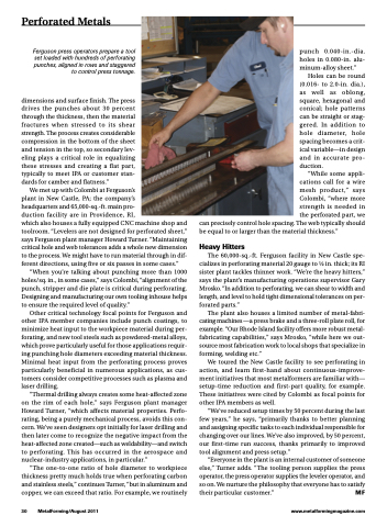

   Ferguson press operators prepare a tool set loaded with hundreds of perforating punches, aligned in rows and staggered
to control press tonnage.
