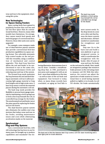

The back loop mode maintains a clock-spring loop beneath the coil as controlled loop storage for the feeder.

The back end of this line features laser loop control, coil-O.D. laser monitoring and a laser light pole for mode detection.
