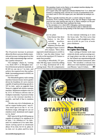

This sampling of parts cut by Twinco on its waterjet machine displays the machine’s broad range of capabilities.
A) A copper-alloy train-signal part waterjet-blanked from 1⁄6-in. sheet and formed in a stamping press; and the set of tools (of prehardened 4140 tool steel) used to form the copper part, also fabricated via waterjet cut- ting.
B) Twinco typically machines this part—a column clamp for elevator structures—from a casting. However, in this case, the flange is longer than usual and the order quantity was only 50, so Twinco waterjet-cut the part from 2-in. hot-rolled steel, then machined the holes.
C) The red plate is 2-in.-thick GPO 3 fiberglass-reinforced polyester.
D) Twinco waterjet-cut 3⁄4-in.-thick aluminum plate to fabricate this wrench, used inhouse during testing of the train stops it manufactures.
