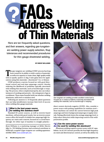

Gas-tungsten-arc welding provides excellent control and a focused arc to reduce problems commonly associated with welding thin materials, such as burnthrough or warping.
