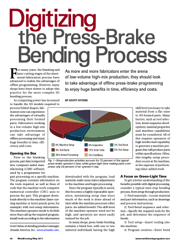

               6% Machine Setup 9% Test Band
28% Actual Processing
6% Inspection 5% Test Bend 15% Enter Data 6% Tool Setup 5% Find/Move
     Fig. 1—Nonproductive activities account for 72 percent of the typical press-brake operator’s time, while green-light time making parts com- prises only 28 percent of an operator’s day.
