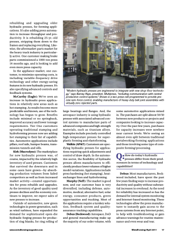

“Modern hydraulic presses are engineered to integrate with new shop-floor technolo- gy,” says Barney Raye, president, Multipress, “including communication with central production-control systems.” Shown is a two-press cell programmed to provide pre- cise ram-force control, enabling manufacture of heavy-duty ball-joint assemblies with virtually zero rejected parts.
