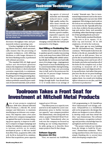

  The assembly room at Principal Mfg. dedicated to build- ing the substructure for the Camaro convertible top includes dozens of new assembly fixtures and jigs, like the one shown here.
