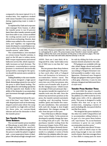

In mid-2008, Fleetwood installed this 1500-ton 96-by-256-in. setup transfer press rated to a whopping 60-in. pitch. The press boasts Linear Transfer’s newer transfer-system design, without the nose-cone structure (of the press on the previous page.) The new design drives the feed rails with belts attached directly to the rail.
