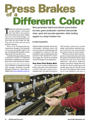

    Electric press brakes prove reliable and efficient, and accurate—down to 1 micron.
