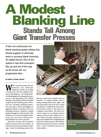

Newman stamps and assembles exhaust systems and door frames, as well as door inners and window mold- ings. It asks its blanking presses (the
400-ton model and a smaller 200-ton blanker) to supply blanks used to stamp, among other parts, right- and left-hand inner and outer door-frame side panels. A rollformed and stretch- formed part welds to the panels to complete each frame. The firm out- sources large two-out blanks used to stamp one-piece door frames for cer- tain vehicle models, produced on a twin-press tandem line comprising two 2000-ton transfer presses with robotic blank feed and an inter-press transfer robot. (All of Newman’s presses are Aida models).
Newman Technology manufactures door frames from these stamped and roll- formed parts.
