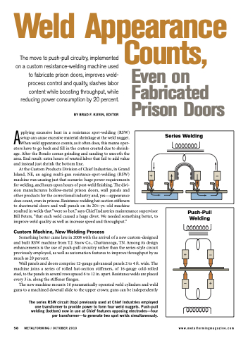

At the Custom Products Division of Chief Industries, in Grand
Island, NE, an aging multi-gun resistance-spot-welding (RSW)
machine was causing just that scenario: huge power requirements
for welding, and hours upon hours of post-weld finishing. The divi-
sion manufactures hollow-metal prison doors, wall panels and
other products for the correctional industry and, yes—appearance
does count, even in prisons. Resistance-welding hat-section stiffeners
to sheetmetal doors and wall panels on its 20+-yr.-old machine
resulted in welds that “were so hot,” says Chief Industries maintenance supervisor Bill Peters, “that each weld caused a huge divot. We needed something better, to improve weld quality as well as increase speed and throughput.”
Custom Machine, New Welding Process
Something better came late in 2008 with the arrival of a new custom-designed and built RSW machine from T.J. Snow Co., Chattanooga, TN. Among its design enhancements is the use of push-pull circuitry rather than the series-style circuit previously employed, as well as automation features to improve throughput by as much as 20 percent.
Wall panels and doors comprise 12-gauge galvanneal panels 2 to 4 ft. wide. The machine joins a series of rolled hat-section stiffeners, of 16-gauge cold-rolled steel, to the panels in several rows spaced 6 to 12 in. apart. Resistance welds are placed every 3 in. along the stiffener flanges.

The series RSW circuit (top) previously used at Chief Industries employed one transformer to provide power to form four weld nuggets. Push-pull welding (bottom) now in use at Chief features opposing electrodes—four per transformer—to generate two spot welds simultaneously.

  Series Welding
                                    Push-Pull Welding
