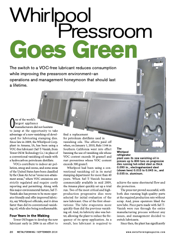

The
Whirlpool
refrigerator
plant uses its new vanishing oil in presses up to 800 tons on progressive dies running hot-rolled steel as thick 0.090 in., electrogalvanized steel (shown here) 0.015 to 0.045 in., and 0.035-in. aluminum.
