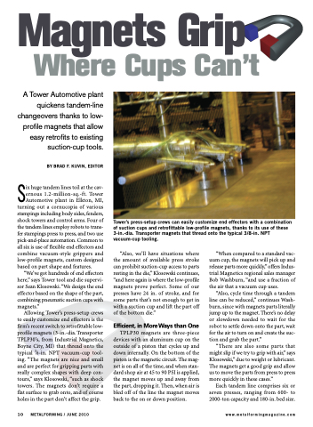

Allowing Tower’s press-setup crews to easily customize end effectors is the firm’s recent switch to retrofittable low- profile magnets (3-in.-dia. Transporter TPLP30’s, from Industrial Magnetics, Boyne City, MI) that thread onto the typical 3⁄8-in. NPT vacuum-cup tool- ing. “The magnets are nice and small and are perfect for gripping parts with really complex shapes with deep con- tours,” says Klosowski, “such as shock towers. The magnets don’t require a flat surface to grab onto, and of course holes in the part don’t affect the grip.
Tower’s press-setup crews can easily customize end effectors with a combination of suction cups and retrofittable low-profile magnets, thanks to its use of these 3-in.-dia. Transporter magnets that thread onto the typical 3/8-in. NPT vacuum-cup tooling.
