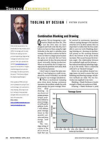

Question: We are designing a com- bination blank and draw die. This is not the first time we have designed and built a die like this, but I believe we have not been using the right formulas in the past to calculate press tonnage. On several occasions we had to move our dies to a larger press because the press we selected did not have enough power. In fact, the press slowed down noticeably during production. When we moved the die to a larger ton- nage press the problem went away. Both are mechanical presses.
I don’t want to repeat the same mis- take so I was hoping you could recom- mend the correct formula(s) we should be using for our tonnage calculations.

The ton- nage rating of a press is the maximum load that can
be exerted in continuous operation without causing damage to the machine structure or to its drive system. But it is important to realize that the force avail- able to carry out work (blanking, draw- ing, forming, etc.) decreases in mechan- ical presses as the working distance above the bottom of the press stroke increases. This occurs because the lever- arm angle—the relationship between the crankshaft angle and the pitman— has reduced mechanical advantage high- er up in the stroke. This is commonly referred to as “derated tonnage.”
Before we can address derated ton- nage issues, we need to ensure that your blanking and drawing tonnage calcula- tion methods are valid. The two for- mulas you supplied to me were:
Blanking = blank thickness x tensile strength x blank circumference/2000
Drawing = blank thickness x yield
Combination Blanking and Drawing
   700 600 500 400 300 200 100
Tonnage Curve
 Tonnage Zone
0.00 0.50 1.00 1.50 2.00 2.50 3.00 3.50 4.00 4.50 5.00
            Inches Up From Bottom
