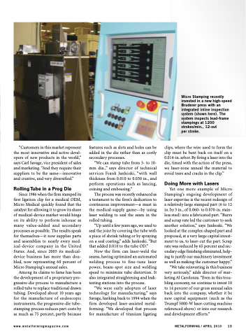

Micro Stamping recently invested in a new high-speed Bruderer press with an integrated inline inspection system (shown here). The system inspects lead-frame stampings at 1200 strokes/min., 12-out
per stroke.
