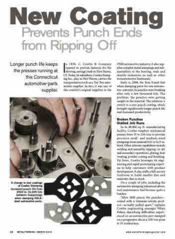

“After 3000 pieces, the punches— coated with a titanium-nitride prod- uct—actually pulled apart,” explains Cowles engineering manager Whyn Pelkey, describing difficulties experi- enced on an automotive part stamped on a progressive die in a 250-ton press at 35 strokes/min.
  A change in tool coatings at Cowles Stamping increased punch life from 3000 to 16,000 hits between sharpenings when stamping HSLA- steel automotive parts.
