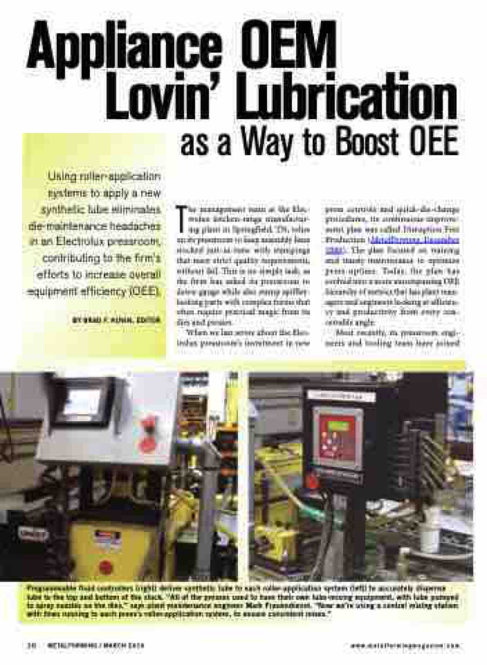

      Programmable fluid controllers (right) deliver synthetic lube to each roller-application system (left) to accurately dispense lube to the top and bottom of the stock. “All of the presses used to have their own lube-mixing equipment, with lube pumped to spray nozzles on the dies,” says plant maintenance engineer Mark Frauendienst. “Now we’re using a central mixing station with lines running to each press’s roller-application system, to ensure consistent mixes.”
