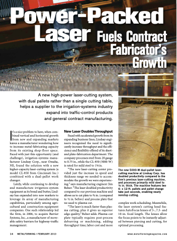

The new 5000-W dual-pallet laser- cutting machine at Lindsay Corp. has doubled productivity compared to the firm’s previous laser-cutting machine, and processes primarily mild steel to 1⁄4 in. thick. The machine features two 6- x 12-ft. pallets and pallet change take just seconds, enabling nearly nonstop cutting.
