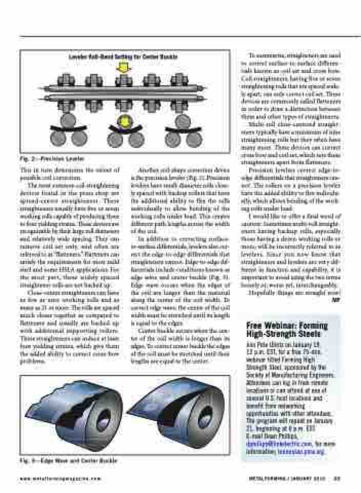

       Leveler Roll-Bend Setting for Center Buckle
                                                                                             Fig. 2—Precision Leveler

Fig. 3—Edge Wave and Center Buckle
Another coil-shape correction device is the precision leveler (Fig. 2). Precision levelers have small-diameter rolls close- ly spaced with backup rollers that have the additional ability to flex the rolls individually to allow bending of the working rolls under load. This creates different path lengths across the width of the coil.
In addition to correcting surface- to-surface differentials, levelers also cor- rect the edge-to-edge differentials that straighteners cannot. Edge-to-edge dif- ferentials include conditions known as edge wave and center buckle (Fig. 3). Edge wave occurs when the edges of the coil are longer than the material along the center of the coil width. To correct edge wave, the center of the coil width must be stretched until its length is equal to the edges.
Center buckle occurs when the cen- ter of the coil width is longer than its edges. To correct center buckle the edges of the coil must be stretched until their lengths are equal to the center.

Precision levelers correct edge-to- edge differentials that straighteners can- not. The rollers on a precision leveler have the added ability to flex individu- ally, which allows bending of the work- ing rolls under load.
