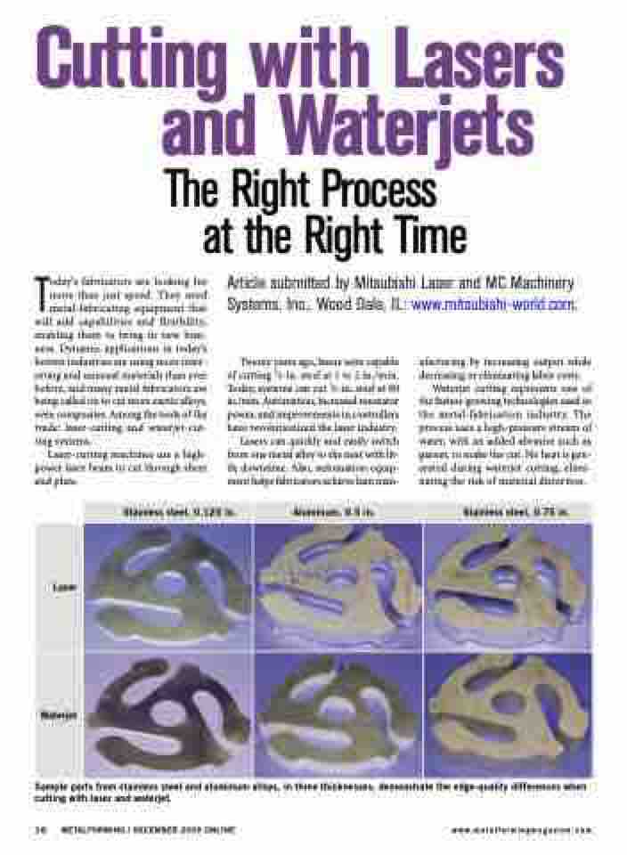

       Stainless steel, 0.125 in.
Aluminum, 0.5 in.
Stainless steel, 0.75 in.
Laser
   Waterjet
          Sample parts from stainless steel and aluminum alloys, in three thicknesses, demonstrate the edge-quality differences when cutting with laser and waterjet.
