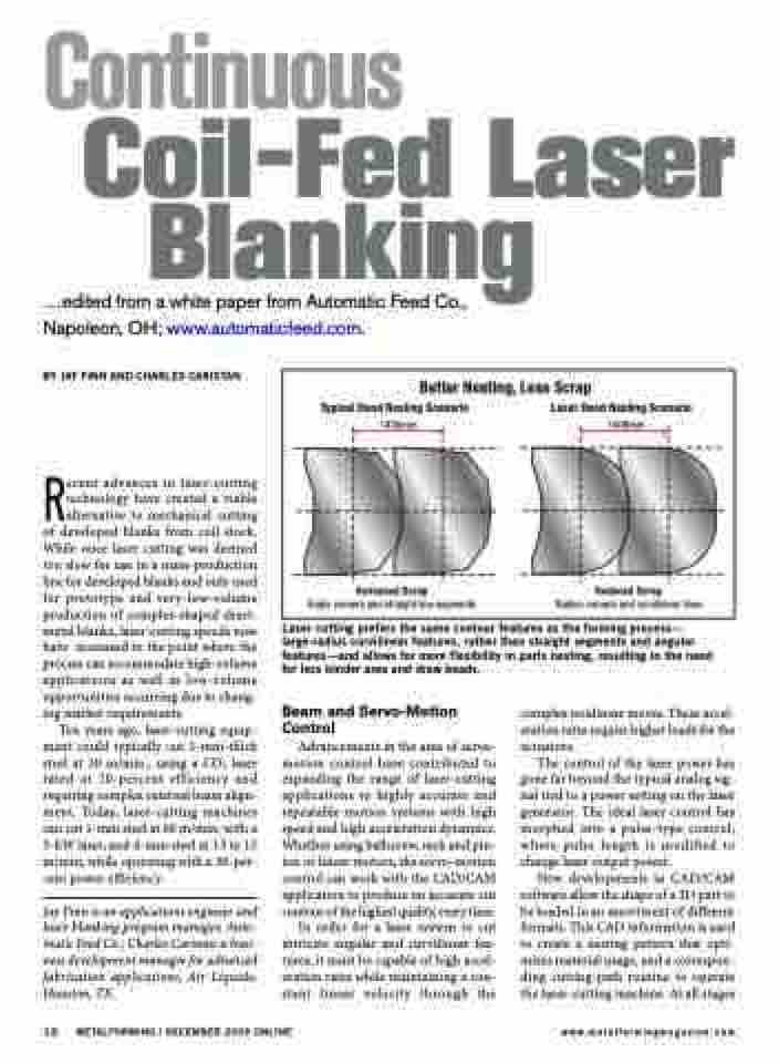

 Typical Hood Nesting Scenario
1430mm
Increased Scrap
Angle corners and straight line segments
Laser Hood Nesting Scenario
1406mm
Reduced Scrap
Radius corners and curvilinear lines

Laser cutting prefers the same contour features as the forming process— large-radius curvilinear features, rather than straight segments and angular features—and allows for more flexibility in parts nesting, resulting in the need for less binder area and draw beads.
